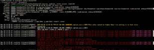

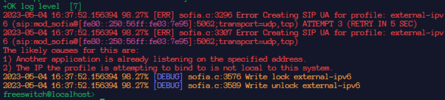

I have already edited the internal sip profiles to 5060 and 5061 and also external sip profiles to 5080 and 5081. But the issue is external ipv6 isn't running. When i restart the freeswitch, it gives this logs..

3,044
565
Are you using ipv6? If not, this shouldn't affect the pbx working. I just tend to disable the ipv6 profiles.

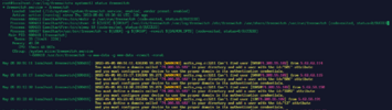

Basically the issue i'm facing is i'm not making calls. I have created extensions but it doesn't registered on softphone. The error it gives is Request timeout error and when i use TLS on softphone then it gives Service Unavailable error.
And the freeswitch logs are:
