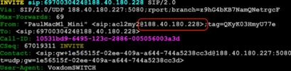

I have tried different dial plan settings like in "dialplan.png", I would like to have the setting please see "gateway.png" dynamic filled with the domain name used.

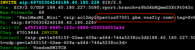

If I set it in the gateway static, I get the invite like "sipinvite_with_fromdomain.png" if I live it empty and try everything in the dial plan I always get just the external IP like in "sipinvite_without_fromdomain.png".

Yes, I have tried that. But I am still getting the IP after the @ like: From: "PaulMacM1_Mini" <sip:302312201111@188.40.180.227>;tag=D92Qpv4UU7N6j
Again, what I am trying to achieve is:
Use a gateway global on all domains, but have the from domain dynamic to the dialing domain or account code after the @ in the from sip invite.
Like when I configure the gateway in the "From Domain" field in gateway configuration as "pavlos57001.pbx.voxfly.com" i get what i want in the sipinvite like:
"From: "PaulMacM1_Mini" <sip:302312201111@pavlos57001.pbx.voxfly.com>;tag=1ZetBXB" the domain name instead the plain IP.
If I leave the ""From Domain" field in gateway configuration empty, I get:
"From: "PaulMacM1_Mini" <sip:302312201111@188.40.180.227>;tag=D92Qpv4UU7N6j"
I would like to use the gateway globally with empty field in the Gateway-configuration without having to create a different gateway configuration for each domain,
and with the dialplan or any other way to send the "from domain: with the value of the dialing domain in the "from" sip invite.
