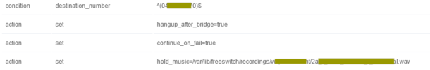

For comparison, I changed hold music on extension, and it is worked well:
7e069629-f5b6-41dd-b36e-9219c2cd439a 2021-01-19 16:09:52.914720 [DEBUG] switch_channel.c:1927 (sofia/internal/20@192.168.29.45:11868) Callstate Change ACTIVE -> HELD
d8c085f8-2e75-4db9-a6b4-dc42337bcf1f 2021-01-19 16:09:53.074722 [DEBUG] switch_ivr.c:632 sofia/external/anonymous@anonymous.invalid Command Execute [depth=0] playback(/var/lib/freeswitch/recordings/vo****.nt/2a_*****.wav)
d8c085f8-2e75-4db9-a6b4-dc42337bcf1f EXECUTE [depth=0] sofia/external/anonymous@anonymous.invalid playback(/var/lib/freeswitch/recordings/voi*****nt/2a_-*****.wav)
d8c085f8-2e75-4db9-a6b4-dc42337bcf1f 2021-01-19 16:09:53.095014 [DEBUG] switch_ivr_play_say.c:1488 Codec Activated L16@8000hz 1 channels 20ms

That hold_music in your inbound route isn't valid. It should show as a local_stream or shout URL
hold_music=local_stream://MessageOnHold for example.
Also check more of your logs or CDR details to follow the dial plan progress. It will show where/when hold music is set or reset before bridging the call.

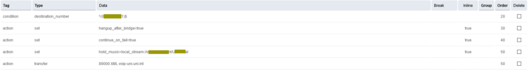

OK, I created custom 'music on hold' with this my hold-music, and then set in destination this custom 'music on hold', in 'inbound routes' it is looks good, but still my hold music goes to default one:
If I use the same custom created 'music on hold', on extension, it is working without any problems. Don't understand what I am missing here.

Be sure you clear cache when updating inbound routes for the changes to take effect immediately.
Other than that, only way to know why it isn't working is to check the FS log or CDR details to see full call flow. There might be another dial plan setting hold_music somewhere.
