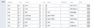

You would normally associate the BLF key with a line or can be "0" if you have only one line. An example of provisioning BLFs in fusion is shown below in the Keys section of the device record:
