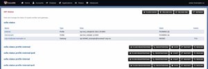

If you go to Status => SIP Status, do you have an "External" profile?
mc6650
Apr 8, 2019
109
61
I believe I have an external profile. Please see the picture. Thanks for the help.

Unfortunately my ipv6 is pretty shotty but I'm not sure if you can run both profiles on 5060 at the same time. Does it complain about the port already being in use?
1,388
364
IPv4 and IPv6 can use the same port, they are a completely different network stack. I run v4 and v6 on the same port. You do not need to put your domain in the "domains" section of the SIP profile.

I have only just noticed your external profile is listening on port 5060, why is this?
mc6650
Apr 8, 2019
109
61
Hello
I see port 5060 as part of the "SIP Profile" settings. I don't recall playing around with these values.
3,038
556
The port setting for the external profile should be 5080 and 5060 for the internal.

Changing the external port to 5080 did the trick. I was able to stop and start the SIP trunk via the GUI as opposed to rebooting the machine. Interestingly when I pulled power plug and then restored the power the trunk / gateway registered; I didn't have to start it from the Gateway window.
Thanks to all those that responded to my question. Thanks you DigitalDaz. This issue is resolved.
