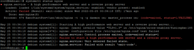

Dear Guys,
Hope all are doing good, This is Saran.
I installed the FusionPBX on Debian 9.
finally, I'm getting an nginx error (screenshot attached). could you pls anyone help to sort out this issue?
Thanks in advance...
*Pls provide any document, how to install FusionPBX properly

I think if you disable TLSv1.3 the your error will go away ( I am guessing) thats what you error is outputting
Its the output im getting.
and could you pls share how to enable the TLSv1.3 and suggest some documents.

why are you using local IP, is this a local install?
did you install letsencrypt?
use the ip address that you received upon completion of the fusionpbx install
nginx can be edited /etc/nginx/nginx.cong for debian
for this error, what i need to edit on nginx.config
pls let me know

If anyone knows, how to enable the nginx.service.
kindly share the steps.
thanks in advance
