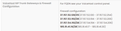

3) Do the CIDRs always have to end in /32 and not a number less than 32? My SIP provider gives me the following when asking for their CIDRs (see below),
4) If 3the above is incorrect do I just need to add/32 to their IP addresses for their Trunk/SBC

Ok I have answered question 3 and that provider is working with the above CIDRs ending in /25 and /28.
DavidShaw
Jan 26, 2021
17
36
I got both working by just adding /32 to the other provider's "POP" IP. If im not mistaken I think CIDRs need to be added to the AC/Node called Domains under the CIDR field of course as you explain. I was also creating a AC per provider, but haven't replicated it... I just deleted everything under the Domain AC/Node and just added CIDRs and done, life is good now :) Thanks for the help friends.
