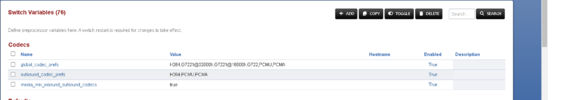

we have setup Fusion and everything went good, only when our Web-Phones calling each other it looks like audio only call, our objective is to make a video call and record it.
so we followed existing information available at https://www.pbxforums.com/threads/video-call.3367/
but in this case somehow, after changing variables, next SIP Status > sofia status profile internal, H264 codec name is missing.
"variables changed here"
"after rescan and even after complete restart"
by running fs_cli -x 'load mod_h26x' command it says.
kindly suggest.

Have you restarted freeswitch after the change? Global configuration may apply only after restart.
Reactions: adrehman
Zivk
Apr 7, 2019
62
In my switches we set the video codec in both outbound_codec_prefs and global_codec_prefs. We also ensure that the internal profile(s) refer to these global definitions in their inbound-codec-prefs and outbound-codec-prefs (these are the defaults). We also make external profile(s) to not use the video codecs, as it drives some operators equipment crazy.

can i do the needed? an extension making video call to another extension and server recording this video? what is wrong in my configuration?

we made some good progress. by following: https://www.pbxforums.com/threads/solved-video-calls-arent-working.3268/
missing parameters are visible now and working also.
FYI, we have already resolved issues related to TURN and STUN Server, as we have perfectly running good Audio Calls from our web client over internet.
now issue is with video calls only, when we make video calls, audio and video both are missing and call remain connected as long as we want
BTW, we are testing video calls with *9196 and calling on other extension.
kindly suggest the way to debug further.
