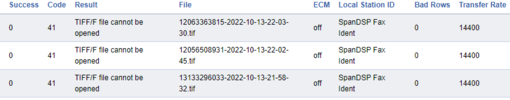

Hello all,
I was running 5.0.3 and just updated to the latest version available under 5.0.4.
When I try receiving a fax, I get these logs:
When I try to send a fax, this occurs:
Has anyone seen similar issues? I had default settings but changed fax_enable_t38_request=false to true as a test. External inbound is being tested from faxzero.com.
The folder in question is /var/lib/freeswitch so it would be the below, but before you do this, do a listing of /var/lib/freeswitch and /var/lib/freeswitch/storage and make sure it's using freeswitch:daemon for everything else.
chown -R freeswitch:daemon /var/lib/freeswitch/storage/fax

I haven't run my command yet, but you're saying I need to run to fix things up, correct? Permissions are to the web server instead of freeswitch which is the issue.
I guess it really depends on whether freeswitch is running as www-data as well. I'm running CentOS so there could be a difference in how they do things there. Maybe I can find the chown statements in the install, I'll check.

Permissions looked right, I ran those commands anyway.
All is working now. Thank you!
This also fixed my inability to upload VM greetings.
