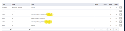

Can you please show me how your DISA Dial Plan Manager is configured so it forces the Outbound CID.
My DISA is configured in a Fusion PBX that haves as it's gateway another Fusion PBX.
So far if I set the Outbound CID on the extension that is dialing the DISA feature code it passes the DID. But if I eliminate the Outbound CID in the extension no Outbound CID is passed down from my DISA Dialplan.
If make a call to my Fusion PBX's IVR and in the options choose the DISA. The CID from my cellphone number is passed through the PBX. It defeats the purpose of the DISA.

Thanks you so much for replying. We manage to set it by just using caller_id! I'll try it out again with those argument in that same order because it makes better sense for documentation purposes.
