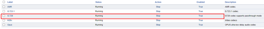

Hi All,
I can't get G729 codec to work.
It seems like my G729 entry in "global_codec_prefs" and "outbound_codec_prefs" are being ignored.
fs_cli -x "show codecs" b | grep g729 gives
codec,G.729,mod_bcg729.
When I make a call I get:
2024-01-23 10:28:09.354570 97.90% [DEBUG] switch_core_media.c:5526 Audio Codec Compare [G729:18:8000:20:8000:1]/[G722:9:8000:20:64000:1]
2024-01-23 10:28:09.354570 97.90% [DEBUG] switch_core_media.c:5526 Audio Codec Compare [G729:18:8000:20:8000:1]/[PCMU:0:8000:20:64000:1]
2024-01-23 10:28:09.354570 97.90% [DEBUG] switch_core_media.c:5526 Audio Codec Compare [G729:18:8000:20:8000:1]/[PCMA:8:8000:20:64000:1]
When I do sofia status profile internal, I get:
CODECS IN G7221@32000h,G7221@16000h,G722,PCMU,PCMA
CODECS OUT G7221@32000h,G7221@16000h,G722,PCMU,PCMA
Under switch varibles i've got:
global_codec_prefsG729,G7221@32000h,G7221@16000h,G722,PCMU,PCMATrue
outbound_codec_prefsG729,PCMU,PCMATrue
Anybody have an idea whats happening here?
Thanks!

ChrisLab
Aug 9, 2023
37
I ended up redoing the work of getting mod_bcg729 loaded etc..
I think my main problem wat that
status profile internal, didn't show G729 anywhere, but it showed under variables page that it was added.
The above now shows G729 included, and the default mod_g729 is disabled/and not running.
I also set the inbound-codec-negotiation to greedy on both profiles.
Thank you for the information provided above!!
I'll look into points 1 & 2.
Thank you!!
1,417
If the codecs listed in 'sofia status profile internal' don't match what you have in variables, check that your profile settings are using
$${outbound_codec_prefs} and $${global_codec_prefs}
If they are try reloading the SIP profiles.
You may need to restart freeswitch if the $${} variables are not getting pre-processed.
I have always set my codecs in each SIP profile rather than using the $${} variables.
