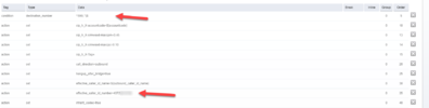

In the image below you can see where I am matching on numbers beginning 500 then stripping off the 500, then in effective caller ID I set the number I want. That sets an Austrian caller id.
In another dialplan, I have ^600(.*)$ that one sets a callerid for Italy etc.

So the number they want to dial for example is 0035311111111 and my carrier wants it sent 35311111111
If the want to dial using Austrian caller id they dial 50035311111111, if they want Italian they use 60035311111111.
