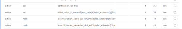

Well, the initial_callee_id_name wasn't set in local_extension, despite being in the template XML files. Not sure what happened there. I just stuck it in at 36:
initial_callee_id_name=${user_data(${dialed_extension}@${domain_name} var effective_caller_id_name)}
Anyway, tried it out and it doesn't seem to send the correct display name in the 183 despite being set. Neither does 'origination_callee_id_name', that just does nothing.
Might be one for the Signalwire forums instead, unless anyone else has got it working. (I personally just use the address book lookup for this purpose)
