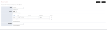

Thanks for the help. It's weird, but when I look at the CDR info it looks like I'm trying to make an inbound call! I've attached screens shots and the log files. Where am I going wrong?

2021-06-17 07:22:38.622315 [DEBUG] sofia.c:10456 verifying acl "domains" for ip/port 192.168.2.52:0.
2021-06-17 07:22:38.622315 [DEBUG] sofia.c:10485 IP 192.168.2.52 Approved by acl "domains[]". Access Granted.
I've got a feeling you've put User Agent subnets in your domain ACL. As per the ACL Documentation:
  • Do not put your public ip or phone IP addresses in the domains access control list.
  • The main purpose is for your carriers ip addresses. Add the carrier IP addresses to the CIDR.
Only your SIP provider's IP addresses should be in there.

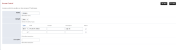

Thanks for pointing that out. I've now amended the ACL, however I still can't make outgoing calls.
677
The default still seems to be set to allow, which will match everything, so everything will be treated as part of the public context.

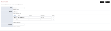

Here's the change I've made to the ACL. Unfortunately my gateway will now not register. Don't know if this is because of the ACL changes or what?
677
Only thing I can imagine is if you're not using montreal9.voip.ms to register. That's definitely the correct set up. Have you done the usual things like flush cache and reloaded the ACL from SIP Status?

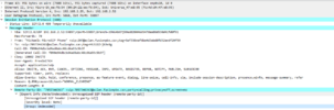

Update. The gateway is now registered and I can receive calls, however outbout still is working. When I look at the WireShark entry for a call I see an authentication error. This I don't understand if the gateway is registered. Please see the attached screen shots.

677
Is it possible voip.ms are rejecting it due to the lack of outbound caller ID?
1,417
The SIP error is a 503 which is a very general "Service Unavailable" error. You would normally expect to see this sort of error when a providers server was down for maintenance or similar. If the issue is caller ID I would have expected the provider to give you a more meaningful error.
If you get a packet capture you may see some more useful text/description associated with the 503 message.

You would stick that on the extension you are calling from Extensions -> Outbound Caller ID Number. It's a wild suggestion, so I can't say for definite why voip.ms rejected the call. It's just I've seen 503 errors used as a place holder error for a lot of misconfiguration over a couple of SIP providers. I think Wireshark doesn't understand what Remote-Party-ID for some reason.
Failing that, it might be worth seeing if it's possible to get voip.ms to let you know what the calls are rejected with packet captures.
