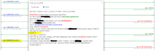

Hi, i hope someone here can give me a little help, in the UK i use voiceflex for my sip trunk provider, i have multiple tennats on multiple nodes so each tenant has their own gateway, partly to make billing easy but also to keep tenant seperate. In the main this has worked fine but just lately i have been having issues with the sip trunks dropping registration to the provider, each tenant has to register because of multiple trunks coming from the same IP so IP auth wont work.
When i contacted the provider they said that when fusionpbx resgiters its fine for a few minutes but then freeswitch sends reg request with 0 set as the timeout which causes the trunk to deregister, they showed me this in a trace so i know its happening, the way round this so far has been to set the trunks reg timer from 800 to 180 which in the main seems to be working but im concerned this is going to come back, so my question is where is the 0 request coming form and how can i stop it ?

I don't to be honest, this system is extremely busy 24/7 however i do have what voiceflex sent me if that helps at all. This happens i now discover on new installs and these slightly older ones as well so this is an ongoing problem it looks like.

Yes, from those screen shots it does look like FreeSWITCH just decides to unregister.
