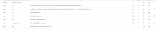

Sorry, i got the issue the same with everyone, and try do add skip_instructions=true but didn't work ! Inbound calls still have the voicemail message before that. So, please intrust me . Thanks a lotfs.png

Sorry, i got the issue the same with everyone, and try do add skip_instructions=true but didn't work ! Inbound calls still have the voicemail message before that. So, please intrust me . Thanks a lotView attachment 2555
I would put it somewhere else... For the entire tenant you can put it in Dialpan > Dialplan Manager under the domain-variables dialplan.. You can also create your own dialplan and match it to a specific extension, voicemail box, IVR, ring group, etc.. or as others have mentioned put it closer to the point that it gets transferred to voicemail (in case you have it enabled somewhere else).
You can also put your code in Dialplan > Inbound Routes and do it for a specific destination number.
Or you can enable it for the whole server by going to Advanced > Variables and creating a new entry under Defaults. So press the Add button Category = Defaults and Name is skip_instructions and/or skip_greeting and the Value is true and Command is set and finally press Save.
I'm not sure if they'll update right away but if not then either apply the global variable manually through fs_cli or just restart FreeSwitch by typing fs_cli -x fsctl shutdown now restart into terminal and wait a couple minutes.
Also, skip_instructions is not the entire message you hear before leaving a voicemail. If you don't want anything to play at all you would need to set both skip_greeting and skip_instructions to true.
skip_greeting => The person at extension ?? is not available.
skip_instructions => Record your message at the tone. Press any key or stop talking to end the recording.
