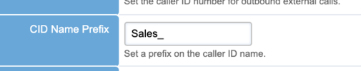

You can use the CID Name Prefix option in the Ring Group you have set up.
All calls to the Ring Group will have the prefix displayed on screen with the Caller ID info, but calls direct to the bookkeeper will not.
Example attached...
