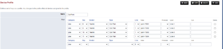

Not sure if this is the solution you were looking for but we setup our call park options to show on BLF. I have included an image of how its configured in the device profile on FusionPBX
Hope this helps!

Hi, @NVT ,
We have the same setup and BLF is working fine, it's just an audio alert that is not working. We need a reminder tone if we have put a call on the park for more than a couple of minutes.
