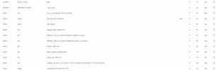

We want to set up multiple gateways, and multiple outbound routes, and then specify which extension has to use a specific outbound route
My point is, if you just are trying to present a different caller id, you do not need multiple trunks if you are using a standard carrier.
I use one carrier with hundreds of caller IDs.
If you do really need a trunk per extension then just add a condition to the outbound route that matches the extension number.
so something like condition caller_id_number=300 etc
Sorry, not to user, here is an example off a live box put it just under the user exists conditionselectiveroute.png....
Thank you.
I will test and let you know what I find
@DigitalDaz, Thank you for your assistance on this matter. You have been great help. It works.
The "condition" "caller_id_number" "^(350)$" (specifying which extensions to make use of this outbound route), works!
