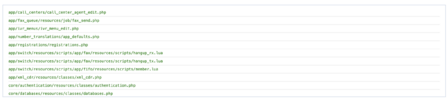

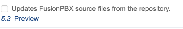

tried to perform an update through the web page today.
When I start the update, I get this error:
Results - Source Code
hint: Pulling without specifying how to reconcile divergent branches is
hint: discouraged. You can squelch this message by running one of the following
hint: commands sometime before your next pull:
hint:
hint: git config pull.rebase false # merge (the default strategy)
hint: git config pull.rebase true # rebase
hint: git config pull.ff only # fast-forward only
hint:
hint: You can replace "git config" with "git config --global" to set a default
hint: preference for all repositories. You can also pass --rebase, --no-rebase,
hint: or --ff-only on the command line to override the configured default per
hint: invocation.
fatal: update_ref failed for ref 'HEAD': cannot update the ref 'refs/heads/5.3': unable to append to '.git/logs/refs/heads/5.3': Permission denied
Updating 9cc6d4577..7308ae1a5
Fast-forward
I’m currently on version 5.3.
Does anyone have any idea?
Thanks, everyone!
