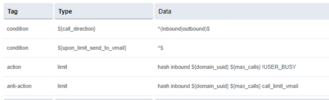

So I made this change:
- Added a "call_limit_vmail" dialplan which is basically a copy of the "send_to_voicemail" dialplan.
- Changed the condition to: 1685989411461.png
- Changed voicemail_id=199 (Ideally, this would use a variable set in domain_variables)
- Added an "answer" right before the lua action.
- Changed the Order for the dialplan to 24 (right before "call_limit") and set continue to "false".
See screenshot below
Then in the "call_limit" dialplan:
- Changed to:
hash inbound ${domain_uuid} ${max_calls} call_limit_vmail
And it seems to be working. The "call_limit_vmail" shows up as destination in CDR, but for now, that's ok.

I did go ahead and add a domain variable, and then I'm considering making the following tweak to the "call-limit" dialplan. 1686065554441.png
That way, if you don't populate a value for "upon_limit_send_to_vmail", it just responds with a busy like it does now by default. If you populate that, then it routes accordingly. And then in the "call_limit_vmail" dialplan, it does:
I'm not sure if this kind of change will be accepted as a PR, though, and I don't want to get my system overall too far from the project.
