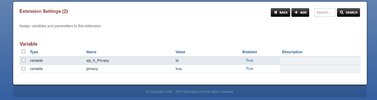

I am either being an idiot or not seeing the option, I have a number of exts that are required to call out anonymously, now I know the *67 works but want to know if there is a way to turn on call privacy for each ext individually for every call.
Found a few guides to mod the default caller id, but to no avail.
Any help would be greatly appreciated.

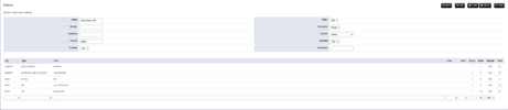

You have a few options. If you want extension 10102 to have privacy turned on all of the time you can build a dialplan looks like this.
Adjust the condition sip from user to your desired extension or group of extensions.
You could build an outbound route that runs before the final outbound route and is a continue = true
No option to add the conditions on my version of Fusion 5.1.0 RC1
Every version of fusion has the ability to add any number of conditions to a dialplan.

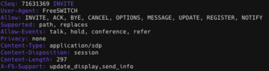

Which bit is not working? eg, is the privacy id set in the outbound invite, etc?
Yeh I set the dial plan as whut as described but its not acting in anyway, still showing outbound / emergency cli
What do you mean it doesn't work? Does the sip message show that privacy is set? It is up to the upstream carrier to handle the private call. If they don't handle it properly the caller ID will still show up.
You might also share what the privacy dialplan looks like that you crafted.
I was playing with it, but I did complete the way whut suggested and still no luck.
Is your call hitting the dialplan? You can see in the fs_cli. Is your caller_id_name anonymous? Is it possible another dialplan is setting the Privacy to none later?
The first item I see that is probably causing this dialplan to not work is the order set at 200. The order needs to be a lower number than your outbound route. Otherwise, this dial plan will never be executed. Your existing outbound route is probably order 100, or similar. Change your new dial plan to order 99, 98, 97, etc. so it can be executed.
