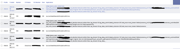

I recently noticed an issue while on the active call screen. I saw few calls still showing up, even though it had ended a few hours ago.
I tried selecting all and hanging up, but I received a notification saying "Call ended: 4," yet nothing changed. The calls are still listed—how do I remove them?
If you are using SQlite for your freeswtch database, you can create a script that will remove stale calls. Sometimes calls get stuck and need to be removed manually.
I've posted a script example here earlier
The root of the problem is a FreeSwitch bug. The script is a work around. I refer to these inactive calls as stale calls.
Thanks for the info, I did a reboot and it resolved it.
I will look into the script part.
