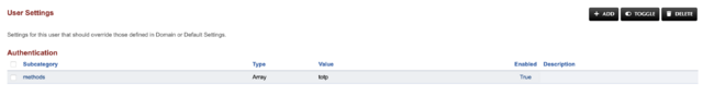

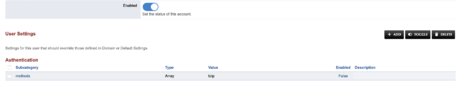

Hi all!
I added totp to False in the user, but it still asks me for the totp.
Any ideas?
Thanks everyone!
If I remember correctly from my Fusion days, you can't override a setting to false in that way. Because you have set Enabled to False, it just means that setting is not enabled at the user level in which case the underlying default setting will be used.
You also have the added complexity that the "Array" type is "added to" so if you have totp in the default settings it will always be there.

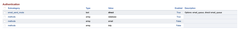

Hi Adrian,
Thank you for giving me an avenue to explore.
I tried to look at the problem the other way around:
In the default settings I deactivated the totp, then in the user I activated the totp.
This allows me to manage who should have the totp and who should not have it.
On the other hand, my problem: a user for whom I activated the totp does not work. Just with the username and password I can log in or this user must have the totp.
If anyone has any leads, let me know!
Thank you all.
