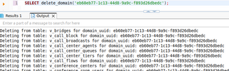

@agree thanks again for the PL SQL I am finding it very useful. I have been testing it have have a couple of changes here - mostly executing the deletes in table order A-Z. Image below of the delete in A-Z table name order.
SQL:
CREATE OR REPLACE FUNCTION delete_domain(id UUID)
RETURNS void AS $$
DECLARE
   r RECORD;
BEGIN
   FOR r IN
       SELECT table_schema, table_name
       FROM information_schema.columns
       JOIN information_schema.tables USING (table_schema, table_name)
       WHERE table_schema = 'public'
         AND table_type = 'BASE TABLE'
         AND table_name LIKE 'v_%'
         AND column_name = 'domain_uuid'
         AND table_name <> 'v_domains'
       ORDER BY table_name
   LOOP
        RAISE NOTICE 'Deleting from table: % for domain_uuid: %', r.table_name, id;
       EXECUTE format('DELETE FROM %I.%I WHERE domain_uuid = $1', r.table_schema, r.table_name) USING id;
   END LOOP;
   RAISE NOTICE 'Deleting from table: v_domains for domain_uuid: %', id;
   EXECUTE 'DELETE FROM public.v_domains WHERE domain_uuid = $1' USING id;
END;
$$ LANGUAGE plpgsql;
