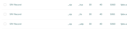

If this is answered anywhere, please point me to the right place. I have already worked with endpoints/extensions registering using fqdn (host.domain.name), I am trying to register with domain.name only. So far, I am able to register endpoint and able to registration. However, when I try to make a test call, it gets rejected at FS and on the phone it say FORBIDDEN. What I dont understand is why the number I call becomes the domain of the extension i.e. I dial *9664 to test and in the FS log it shows (2022-07-04 23:36:00.414277 98.20% [WARNING] sofia_reg.c:3223 Can't find user [200@*9664] from 7x.xx.xx.x)
1. I have SRV records setup:
