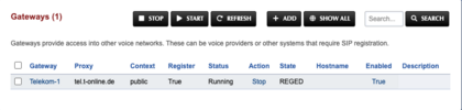

Gateway to my sip provider:

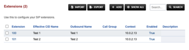

2 extensions (100 and 101):
