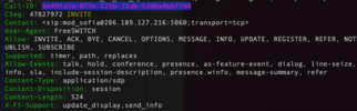

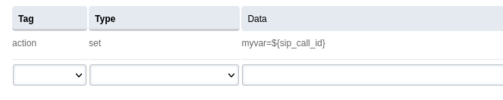

Thanks- sip_call_id is given me a different data and not picking up the call-id in the sip invite.
As you suggested- i am using -- callid=${sip_call_id} but it is picking up a different value

I believe what is shown in the CDR is the sip_call_id for the A-leg of the call. As FusionPBX (FreeSWITCH) is a back to back user agent (B2BUA) there will be a different sip_call_id on the B-leg. I don't believe it is possible to get the B-leg sip_call_id within the dial plan.

The info app can be just dropped in anywhere, obviously, you will need it in the right place, in the gui it looks like:
The in fs_cli you should see all the variables available with values so if you can see your value, you should be able to see the relevant variable name.
