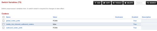

I have a weird problem on internal calls alone, i.e between extensions, the first hello of the callee is never heard by the caller - I just did a packet capture and the first RTP packet alone has a huge delta, it also has a status message saying Payload changed to PT=8 - this message occurs on all internal extension to extension calls on the first RTP packet. There is also a frequency drift in wireshark? I don't know whether it is relevant or not, but the quality of the audio is not acceptable - there are cracks and pops in the voice and not pleasant to the listener.
However if a call is established from the internal extension to a PSTN gateway, the first RTP packet doesn't have the status message saying payload changed to PT=8, the external PSTN gateway only accepts PCMA. The outbound and inbound codecs on the freeswitch is set to PCMA. The sip clients also send PCMA as the only codec during invite. The quaity of audio when the call is made to PSTN is far superior than internal extension to extension calls.

with ulaw on the phones, the call doesn't complete because freeswitch is configured only with PCMA as the only preferred codec. the PSTN here supports only PCMA, just to clarify only the first Hello or what ever is spoken/transmitted in the first packet which has the huge delta is missed out, rest of the conversation is heard, abeit with jitter losses.
The payload setting might be a shift from the ringback tone to actual voice audio codec.
When a call is made from the extension to an external gateway - the "unassigned" is not present in the payload field of wireshark capture.
On the log file I find this for both internal calls and for external calls.
2322c122-070a-11ec-9142-c727a551bb6a 2021-08-27 13:10:34.450960 [DEBUG] switch_ivr_originate.c:1333 Raw Codec Activation Success L16@8000hz 1 channel 20ms 2322c122-070a-11ec-9142-c727a551bb6a 2021-08-27 13:10:34.450960 [DEBUG] switch_core_codec.c:223 sofia/internal/11@192.168.1.2 Push codec L16:100 2322c122-070a-11ec-9142-c727a551bb6a 2021-08-27 13:10:34.450960 [DEBUG] switch_ivr_originate.c:1407 Play Ringback Tone [%(400,200,400,450);%(400,2000,400,450)] 2322c122-070a-11ec-9142-c727a551bb6a 2021-08-27 13:10:34.470948 [DEBUG] sofia.c:7325 Channel sofia/internal/11@192.168.1.2 entering state
