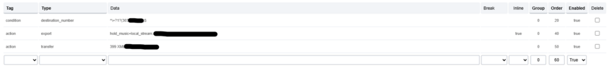

Thanks for the reply, my dial plan is the default one set when creating a destination so that has not been changed. Does the PBX override it by default? Below is my default dial plan on our main line.

Would this be added to the inbound or outbound dialplan? I am unable to find that option.
By default FusionPBX keeps the original caller ID and passes it through.
However, some providers require the diversion header that was shown by @soglinda
If your version of FusionPBX is new, the Diversion header option is there by default. If you have an older system, then you might need to upgrade. If you have already upgraded, delete the call-forward-all dialplan and run Advanced -> Upgrade -> App Defaults. Then you will have the new updated call-forward-all dialplan. At that point, you can set Enabled to true on the sip_h_Diversion header.
Please note this requires your VoIP provider to support the Diversion header. Some of them don't support it, which is why it's off by default.
