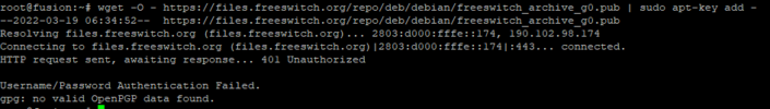

Hi
I installed FusionPBX latest version just a few days ago and it installed flawlessly.
I am trying to install it on a new server with Debian 11, and FusionPBX installs correctly but freeswitch installation fails.
I use auto install script of FusionPBX. In logs I have found that freeswitch gpg key installation fails.
I have tried using:
wget -O - https://files.freeswitch.org/repo/deb/debian/freeswitch_archive_g0.pub | sudo apt-key add -
and
curl https://files.freeswitch.org/repo/deb/debian/freeswitch_archive_g0.pub | add-key add -
but no luck. In logs it says User/Password Authetication failed.
Can anyone explain please why this is hapenning? I have tried it multiple times.
flagman
Dec 1, 2020
30
You have to register a free account at signalwire website and get the token. This is a recent change made by signalwire.
