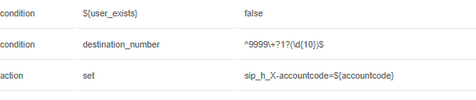

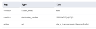

You need a route that is prefixed with 9999. See the screenshot attached.
To separate regular routes and fax routes, we use a prefix.
Make sure FreeSWITCH is selecting this route when the fax call goes out. I have the service running smoothly for clients that send thousands of faxes every day.
