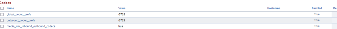

We Can make Internal calls via G722 but not via G729
We have loaded the G729 codec (codec,G.729,mod_g729) calls is showing completed on the cdr but it has not been completed, the destination did not ring
Please find screesnhots shot and logs below.
mod_g729 as far as I am aware is a licensed product, have you installed the license?
