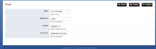

ok, thanks a lot, I'm going to try this now. The only difference is that I am not leaving through a gateway but through a merge extension (10000), which provides service to an external SIP line from the other central. In the string bridge = sofia / gateway / {your gateway here} / * 47 * 12340 $ 1 I'm going to try putting bridge = sofia / gateway / 10000 / * 47 * 12340 $ 1, I have a bridge as shown in the attached screen print . I will keep abreast of the results.

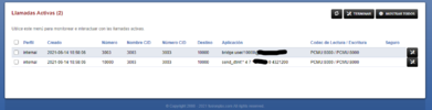

I have tried. the call goes out but is cut off. If I disc manually and very slowly it calls without problems. I'm going to rest a bit. then I go on and see maybe how to determine the transmission time of dtmf. it may take longer to emit the dtmf tone. In active calls application column it says: send dtmf * 47 * 12340number. I will keep you posted. Greetings.
