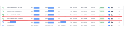

I encountered the same issue and had to make substantial modifications to the CDR report and its display format. I successfully adjusted the page to present one line per call, with details of the attempted agents included in the expanded view. Achieving this outcome required considerable effort, but it is certainly feasible.

There have been a lot of improvements to Call Detail Records in FusionPBX 5.2 and 5.3. There will be more in the future 5.4 release.
