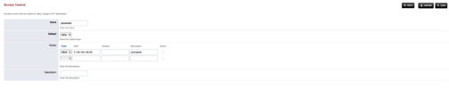

I have the Problem that the Incoming Calls not working, the ACL set to the carrier IP address.
ACL: 5.148.166.196/32 (I have test 5.148.166.196/28 = https://support.phonestar.ch/help/de-de/11-richtlinien-zur-netzwerkkonfiguration/5-firewall)
I have set the pxxxxxxxx.xxxxx.phonestar.ch as Domain into ACL but the same.

First things first, remove the domain name from the ACL. You rarely ever want that there. Only the CIDR IP Addresses of the providers SBCs for IP Authentication.

The Domain in the ACL was for testing, now only the CIDR IP Adresses from my provider into the ACL.
