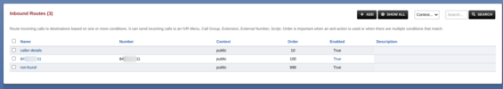

Hi, I'm trying to setup FS PBX with callcentric DID.
The outgoing is working perfectly but the incoming call are not working.and HANGUP with cause: UNALLOCATED_NUMBER
I'm suspecting the problem here:
Callcentric rather than sending the invite like this:
INVITE sip:184****701@my-pbx-ip
It is sending like this:
INVITE sip:gw+UUID@my-pbx-ip
To: sip:184****7011@my-domain

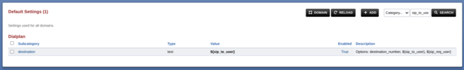

I tried my best so that inbound calls being matched using sip_to_user but no success. I attached my current setup screen shoots bellow.
I guess this is the critical log:
EXECUTE [depth=0] sofia/external/918********3@sip.callcentric.net log(WARNING [inbound routes] 404 not found 199.87.144.69 destination_number 1777MYCCID sip_to_user 184****7011 sip_req_user gw+5186173e-28cd-48e7-aa3e-7b3188cad50e)
