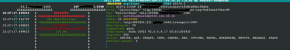

Hi All,
I'm having an issue with incoming calls not working into my FusionPBX.
The IP address is added in the Access control

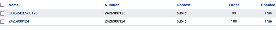

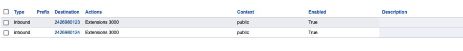

Inbound routes setup
I can see the call hitting the PBX in the pcap.
Any help would be greatly appreciated
It would appear you have some NAT/Firewall issue there. Either that or the source IP is banned in fail2ban.
As you can see, the INVITE is being received but there is no reply being sent out.
When you added the IP to the ACL, did you reload ACLs?
Check the freeswitch log, or watch from the console to see if the call is even hitting freeswitch.
Sorry I should have sent the entire trace.
Yes I reload the ACL after adding the IP address.
