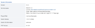

Tried installing the maintenance app. Get to the point where I upgrade the schema and I see
Uncaught TypeError: Cannot access offset of type string on string in /var/www/fusionpbx/resources/classes/schema.php:587
Now if I logout and then log in again the menu has gone! Any ideas
System info
