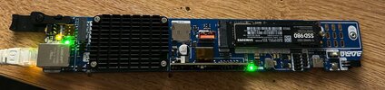

I am running a Pi4 with 4Gb memory, running off a 128Gb M2 SSD. This is the second of these i have tried just to rule out a dodgy PI. Sd cards i use to initially install this onto the machine has changed a few times also, all well known brands (Kingston/Sandisk genuine and even a couple of lesser known cards that whilst not massivent popular have proved themselves over the last couple of years).
