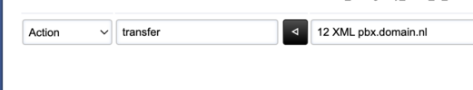

It can be done. You need a dialpan entry to transfer to EXT XML domain_name. So in your example, it will be
 12 XML pbx.domain.nl
I believe this will work.
