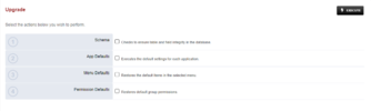

'Schema' -> This goes through each FusionPBX 'app' and ensures the PostGreSQL tables are the correct type. I think it fixes columns if possible. This doesn't happen often.
'App Defaults' -> Sets the 'Default Settings' to their default state, and adds them if they aren't present.
'Menu Defaults' -> Resets the menu bar at the top back to default and adds any new items if there are some.
'Permission Defaults' -> Resets the Group Permissions and adds any new permissions if there are some.
This usually gets you back to the 'clean' state without breaking your config for extensions, etc.

The "Source Code" upgrade option is missing, that's what I was referring to.
It seems the upgrade process on that doc is outdated or goes off something else (stable repo)? Not finding the /usr/local/freeswitch was making me look in the wrong places since /var/www/fusionpbx is what broke (for the most part).
