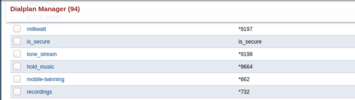

sdavison
Feb 9, 2021
47
Mine did not work without creating an inbound rule even though the 390_mobile_twinning.xml file was copied to that path.
1,412
Yes,
I have realised that the upgrade instructions do not include Add Defaults - there may be a good reason, but I have put in a pull request with an update. App Defaults (amongst other things) reads the xml files in /var/www/fusionpbx/app/dialplans/resources/switch/conf/dialplan and makes sure they get picked up into the dialplan.
I also noticed that 390_mobile_twinning.xml did not have the order="390" attribute in the extension tag.
Once I had run App Defaults, with the modified xml file to include the order, mobile-twinning appears in the Dialplan Manager:

Yes,
boom, this got it working for me, changed the order and did app defaults, cheers Adrian!
