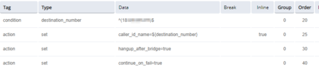

Another way would be to edit the inbound route for each DID to reset caller_id_name or caller_id_number to be equal to ${destination_number}
