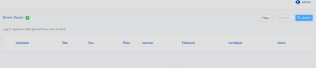

Shows Blank , some menus are blank IDK why. is there any alternative way to check if IP was banned.

Check this next. Go to Advanced -> Access controls, make sure your public IP address for your phones are not in the providers access control list.
If the phone IP address is in that list, then remove it. Then press the RELOAD button or go to Status -> SIP STATUS and press the RELOADACL button.
