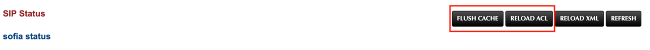

2. On FusionPBX under Status->SIP Status, RELOAD ACL and FLUSH CACHE.
