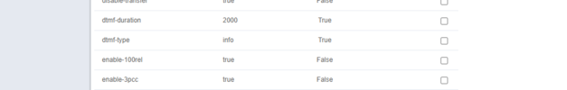

i have an hikvision intercom (door) , hikvision indoor panel and some linphone sip clients
when i call from doorstation, when i accept call with linphone clients, i can press #1 , that opens the door
from the indoor panel, i have there a key button, but that doesnt open the door, instead i get message 405 not allowed
this used to work on freepbx? how i can allow this type of message , so i can also open door from indoor panels?
sreenshot 1 : log from indoor panel
screenshot 2 : log from linphone, seems it uses dtmf there..
so i need to allow somthing in fusionpbx , no sure how i need to configure it?
thnx

So maybe the 405 is not the actual reason it is not working with FusionPBX?
Ok, that's something I can change in fusionpbx right? Gonna have a look later, it should be on default settings now , not sure how that's configured
Yes, by default is is set to rfc2833 in the SIP profile. You can override it using channel variables as shown in the link above.
that was it!!
