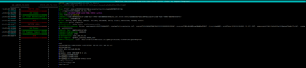

I gto log by sngrep, I think teh problem is in the Proxy Auth phase
I attached my trunk config and log, could you help me please ?

I can't find your trunk provider's settings to assist much. From what I can tell the network part looks fine, but I would expect them to return a 401 Unauthorised instead of 408 Timeout. You checked the username and password, from, etc are all correct?
1,416
Your provider is returning a 100 Trying after you have sent credentials. As @hfoster says, if there is something wrong with your credentials, a 401 response would be more appropriate than a 408. This could be an internal fault with your provider. I would send the packet capture to them and ask for their comments.
