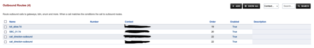

@rabbidiesel I was able to get it to work however, there is a issue. All extension seems to be using this route whether or not I put the toll_allow on the extension. SBC_01 is the route all other extension should be using
Can you look at the photo and see if i'm doing anything wrong
Thanks in advance.

@mevans1974, you don’t seem to have a toll_allow on the outbound route.
If you look under the pictures I originally sent, you will see that the second item on the outbound route is a condition with a type of toll_allow.
Please try adding that and let me know.

@rabbidiesel _ Thank you very much, that worked like a charm.

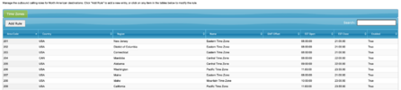

We've added a Time Zone table based on Area Code to our instance which covers Canada and the US. We call al lua script (timezone.lua) when the toll_allow "timezone" is present on the user's extension. We did this because we wanted to be able to control by Area Code within each Time Zone. If the Area Code of the phone number being dialed matches an entry in the table, and the caller has "timezone" under their extension "Toll Allow", then the person calling out will hear the messages "You are attempting to dial a phone number in a time zone which is presently closed. Hang up and try your call when the time zone is open." and then the call is terminated.
We are now implementing a Statutory Holiday table which will also be based on Area Code within each Province (for Canada) and state (US). If the current date matches a date in the table, and the Area Code matches, and the caller has "stat_holiday" under their extension "Toll Allow", then the person calling out will hear the messages "You are attempting to dial a phone number in a location presently observing a holiday. Due to compliance rules, this is not permitted." and then the call is terminated.
In both instances we have a screen that permitted users can access to add / modify / delete entries as required.
This method works extremely well for us.
