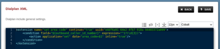

Most outbound routes tend to have a dialplan order of ~100, so what ever you create must have a lower number in order for it to have an effect on your outbound route.
Probably the easiest way of creating a new dialplan record in Fusion is to simple copy an existing one. So pic a simple one like is_local, check the box at the side of it and click the copy button.
Now edit the copy, change its' name, order and the dialplan details and click save. You should end up with something that looks like this:
And if you click on the XML button, you should see something like this:
I hope that helps.
Adrian.
